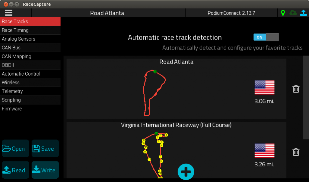

Double check your tracks are added for automatic detection
While you’re at it, ensure you have all of your tracks listed under Setup / Race Tracks. This is necessary so PodiumConnect can calculate lap times.
Fortunately, it’s something you only need to do once! Press the (+) button to browse and select tracks to add them to the list. When done, Write it to your PodiumConnect system.
