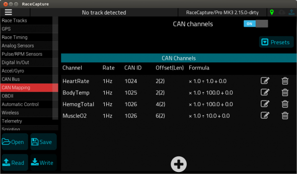

Setup is easy once you have the connections wired to your RaceCapture or PodiumConnect system (see the relevant documentation for hardware connections in our wiki)

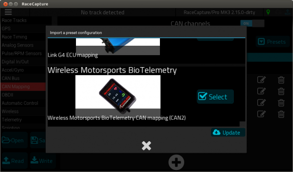

To start, just go into Setup / CAN channels and press the Presets button. Then, press the cloud update button to get the latest presets.
Select the Wireless Motorsports BioTelemetry preset and it will be added to your list of CAN mapped channels – ready for logging or broadcast in real time to Podium.
wireless_motorsports_biotelemetry_channels
This preset is defaulted to CAN2, but can be changed to CAN1 by editing each channel. Be sure to also set the CAN bus to 1MB to match the baud rate of the BioTelemetry device – this can be set under Setup/CAN Bus.
Once you have it mapped and connected, you will be able to see the driver biometrics along side all of your other sensor data.
