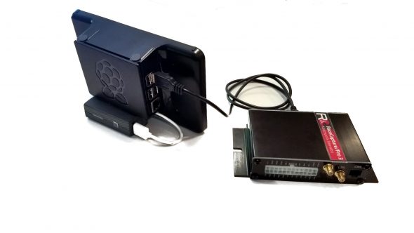

We designed the RaceCapture app to run nearly anywhere -Windows, OS X, Android and iOS. And now, for about $100 you can create a hardwired, dedicated dash for your RaceCapture system using a Raspberry Pi!
racecapture_raspberry_pi
You’ll get all of the benefits of a dedicated dash:
  • Automatically runs upon power up – no app to launch.
  • Hard-wired data connection to RaceCapture – no wireless connections to configure, with the reliability of a direct wire.
  • Runs on the bare metal – The RaceCapture app runs without Android or iOS; no other apps competing for resources, or compromising system stability.
  • Overheating resistance – Your typical mobile device requires extra care to prevent damage to it’s internal battery, and will shut down if overheated. With proper heat-sinking, the Raspberry Pi should handle the heat.
racecapture_raspberry_pi_backside
Experimental!
It’s brand new and super experimental – it’s currently ideal for those adventurous race car hackers who know their away around a command line, comfortable working with hardware and want to dig in.
Think it’s cool, but too much to tackle? Rope in your nearest computer/electronics geek – you need one on your race team, anyway. 🙂
racecapture_raspberry_pi_connections
Get started today
To make it as easy as possible, we created a package that’s ready to run on a nearly bone-stock Raspberry Pi disk image.  Check out our Wiki for the full writeup and instructions and try it today!
