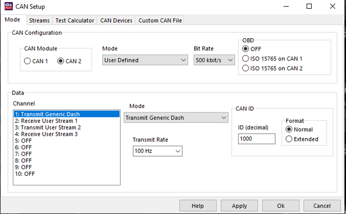

Configuring the Link G5 ECU
Before loading the preset in RaceCapture App, you’ll need to enable CAN output on the Link G5 side. In Link ECU software (PCLink), enable Transmit Generic Dash on either CAN 1 or CAN 2 — whichever port you’re wiring to RaceCapture. Set the CAN ID to 1000 and the bit rate to match your CAN bus or your RaceCapture configuration (typically 1Mbit/s, but confirm it matches on both ends).
