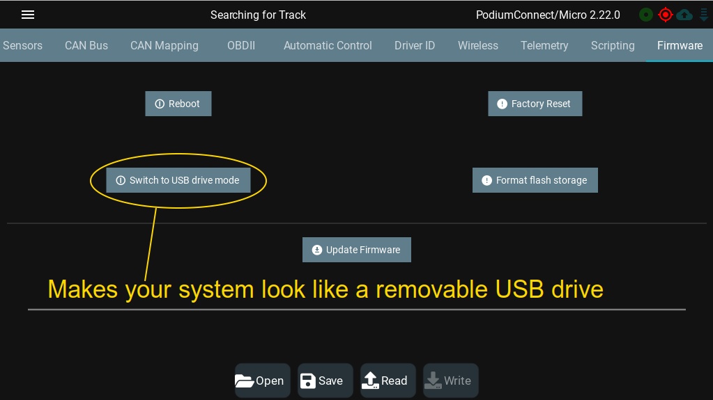

PodiumConnect/Micro ‘s focus is around broadcasting live telemetry, but the system will also log data locally. To transfer log files directly to your computer, you can switch the system into the equivalent of a USB flash drive so you can transfer log files.
To enable this mode, ensure the app is connected to your system (Desktop or Mobile), then navigate to Setup / Firmware. Press the Switch to USB drive mode button.
Caveats:
* App connectivity is temporarily disrupted if the app is connected via USB (Windows, MacOS, Linux)
* You must not be actively logging or broadcasting telemetry before switching to USB drive mode
To get back to normal operation, just fully power cycle the system by ensuring USB and 12v power are disconnected.

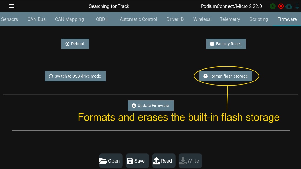

Formatting the flash memory
To format the flash memory, ensure the system is connected to your device (Desktop or Mobile) – then navigate to Setup / Firmware. There you will find the Format flash storage button. Pressing it will format and erase all contents.
Remember, this flash storage only holds data logs and other cached data – it won’t wipe your system’s config or firmware.
