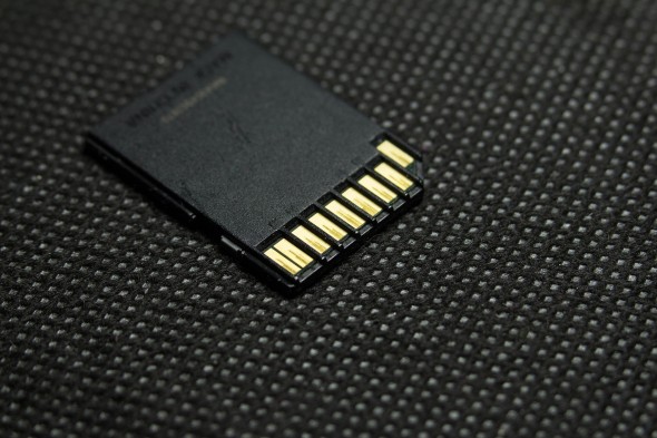

SD Card Logging Improvements
We have improved the stability of our SD card logging code in this release. The result: users can expect a more reliable experience when it comes to recording data and to help deal with unrecognized, unsupported or improperly formatted cards. Also, several changes were made including increasing the logging stack size to help prevent stack overflows. We also optimized code to help prevent unnecessary delays during SD card initialization, and finally – we addressed an issue where the SD card could be initialized twice, potentially causing undefined behavior. In all, a lot of improvements were made and we hope to continue making further improvements in later releases.
