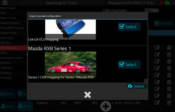

We are pleased to announce a direct CAN mapping for the Mazda RX8 (Series 1).  This is especially great since it bypasses the OBDII interface for fast and efficient streaming of data.  Special thanks to Nick Owens for working with the Mazda community and bringing this preset to you.
mazda_rx8_s1_preset

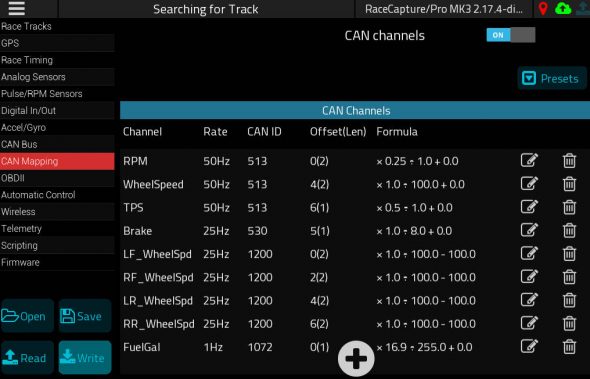

The preset brings in 9 valuable channels of engine data.  More may be possible as the community continues to research!
mazda_rx8_s1_preset_channels
Using the preset is easy; just connect to your system using USB or wireless (on mobile) and navigate to Setup / CAN mapping.  Press the Presets button, and then press the cloud update button.  Find and select the RX8 preset, then write your settings to your system.
