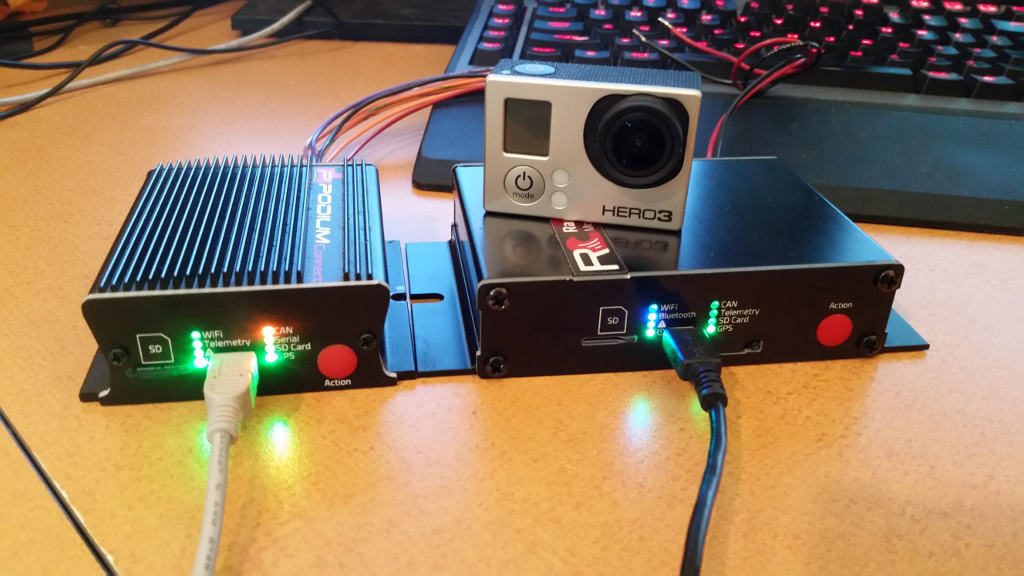

Unlocks a big new feature: Automatic Logging and Camera Control
The 2.13.5 firmware unlocks a huge new feature – automatic logging and camera control. The feature has been waiting for you in the latest RaceCapture App, and now with the 2.13.5 firmware you can finally use it.
Automatic Logging
We have an easy to use interface for controlling when logging happens on your local SD card (RaceCapture/Apex, RaceCapture/Pro and PodiumConnect).
You can specify:
- Which channel to trigger from (Speed, Battery Voltage, RPM, or any other channel)
- The threshold value to trigger at
- The time delay for when the trigger activates
This will let you precisely control how and when logging occurs, with the smarts and flexibility to help minimize fragmented log files.
Camera Control
Read the full guide here on how to set it up But in short, the quick-start involves:
- Enabling app WiFi control on your camera, and noting the SSID and password
- Configure RaceCapture’s WiFi client to connect to the GoPro camera using the SSID and password you specified
- Configure the start trigger with the parameters you want and test!
Note:
- Due to variances in GoPro hero cameras, especially with Hero 4/5 WiFi stability, the camera control is currently considered experimental for Hero 4/5.
- Due to limitations in the WiFi integration, built-in WiFi control is not supported on RaceCapture/Pro MK2. However, you can still control GoPro cameras as before using Lua scripting, as documented in the wiki.
